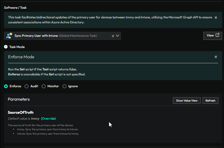

Hi, has anyone come across this? The Entra Join task runs ok but when you look at the device in Entra, the wrong owner is assigned. The owner is not the user but is in the format package_hexstring
Maybe this- not 100% sure though:
Make a second deployment, ordered after the Entra join one
Select task: “Sync Primary User with Intune” and set “SourceOfTruth” to Immy. This should set the primary user defined in immybot as the primary user in Entra.
Hi, thanks for the response. Support responded - yes you use that task but you need to set up a custom app reg first with the required permissions.
