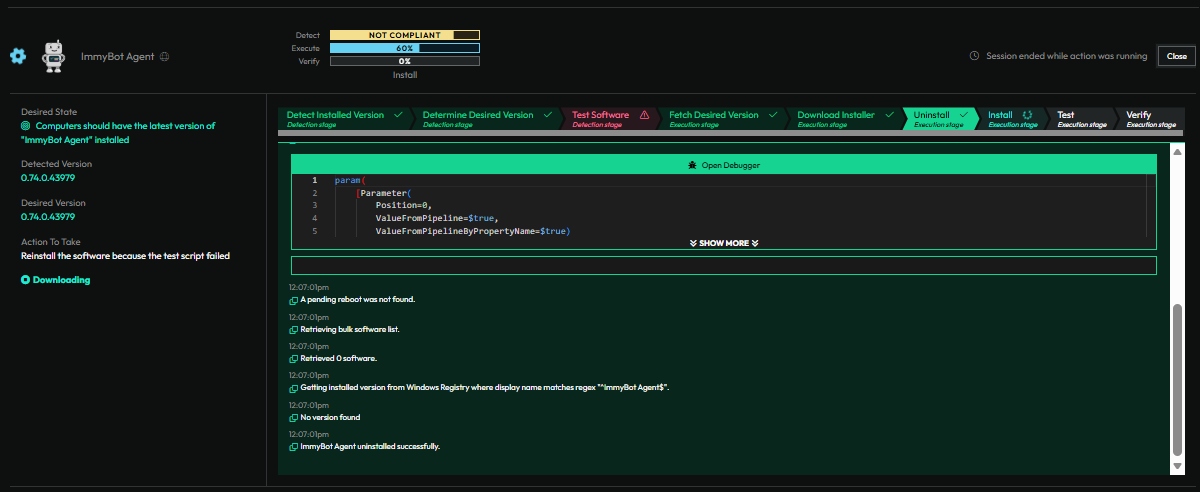

ImmyBot Agent test script failing, leads to immybot uninstalling itself

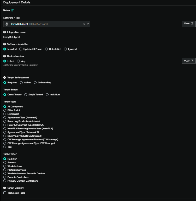

Am I using the recommended method to update the immy agent?
We have a deployment for ImmyBot Agent, applied to all machines with no filter.

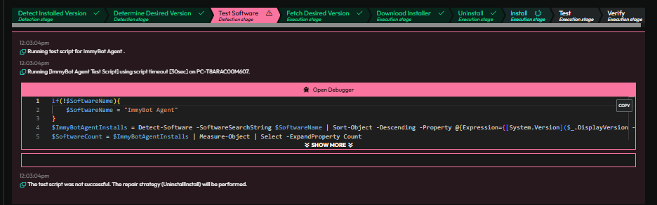

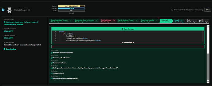

My issues: We’ve had this deployment set up for years, but recently i’ve notived immy trying to update itself by uninstalling and reinstalling due to test script failing. The reinstall fails, I assume because immy was removed from the device.
