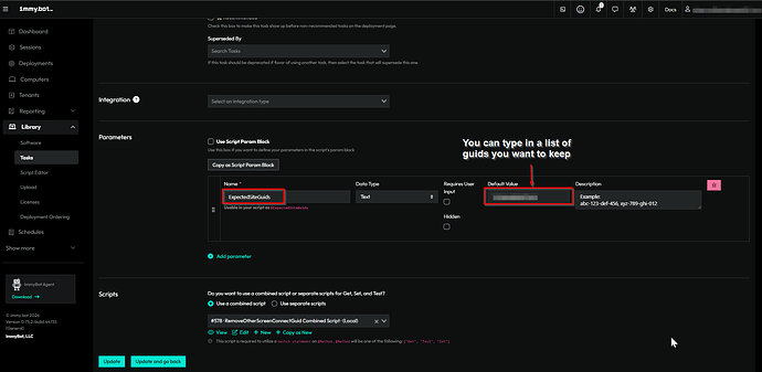

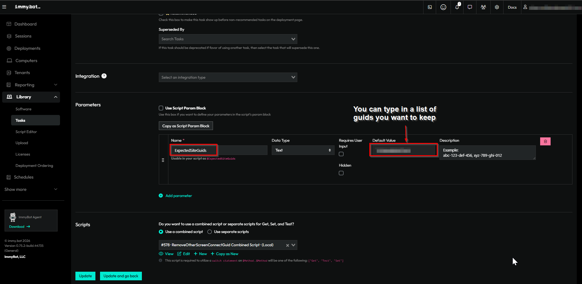

I agree! We actually made a custom task a while back to do that exact thing!
You just need to make a new task give it a name, then set a parameter called:
ExpectedSiteGuids
You can put the guids you want to keep using commas to separate them. (Make sure to test the task on a test machine first to make sure you are targeting the right fingerprints!!!)

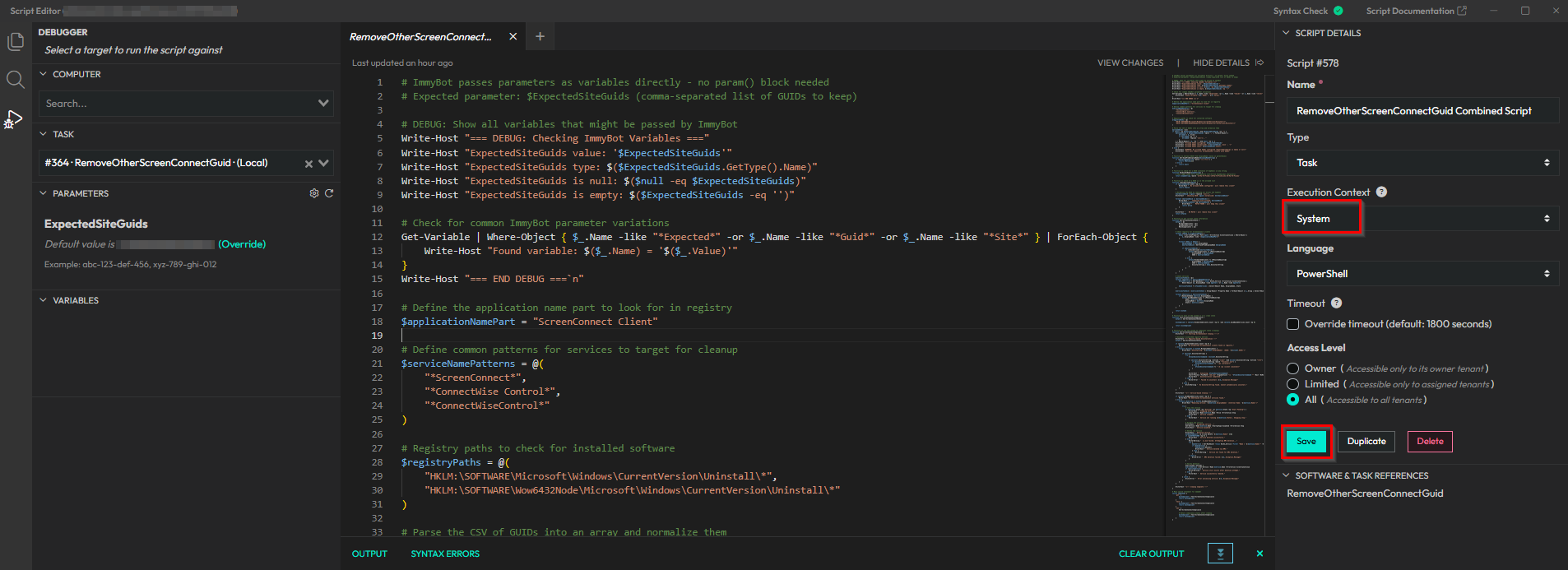

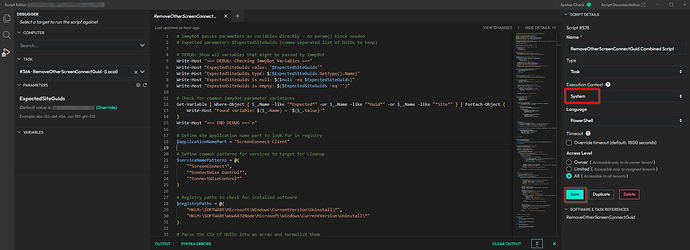

Then chose a new combined script. Select System for the context and below is the code we used. (Feel free to take a look)
