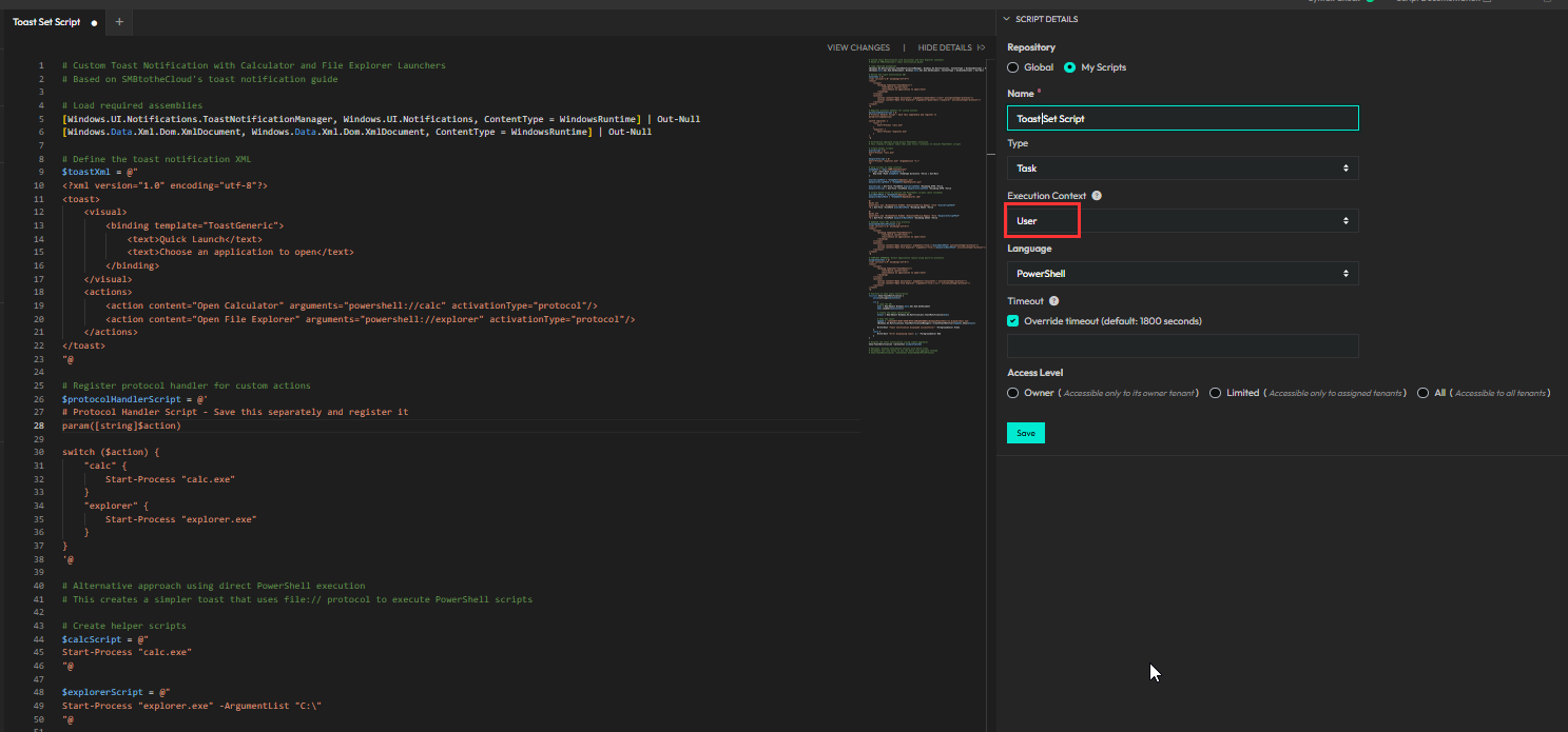

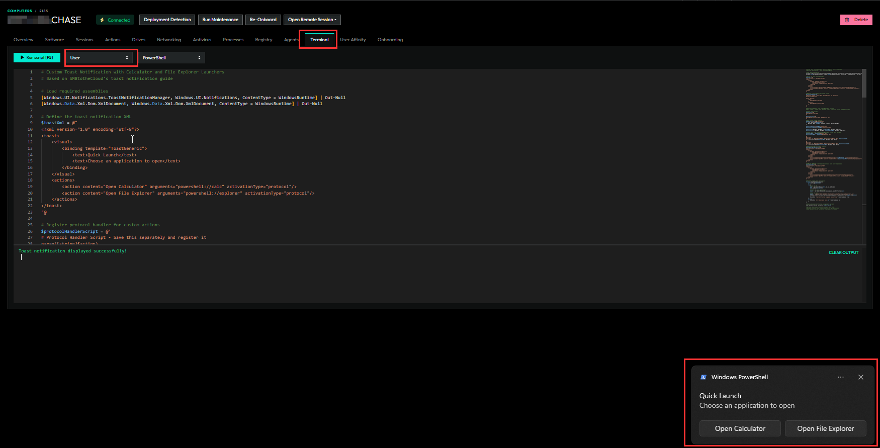

I feel like this is definitely possible. I haven’t done much testing, but you might be able to make a custom task with PowerShell that runs in user context to display a toast notification.
Also, you can use Chat-GPT/Claude and the user context terminal on your computer to test it and have it display what you’d like it to.

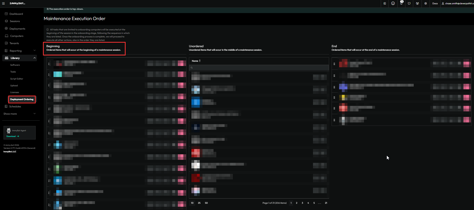

Then just make that a deployment and the order it to the top of the list. Then it should run in Full Maintenance Schedules and notify the user.

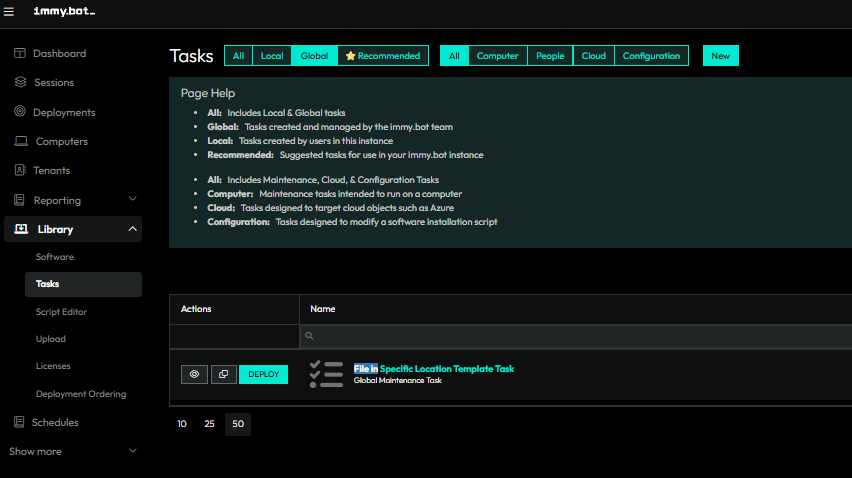

Also, if you wanted to get really crazy, I bet you could duplicate the File in place task to set an icon image somewhere and call the icon location in your toast PowerShell to get your branding.
Here’s a template for PowerShell and toast notifications that you could mod:
