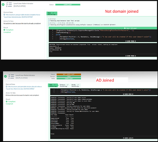

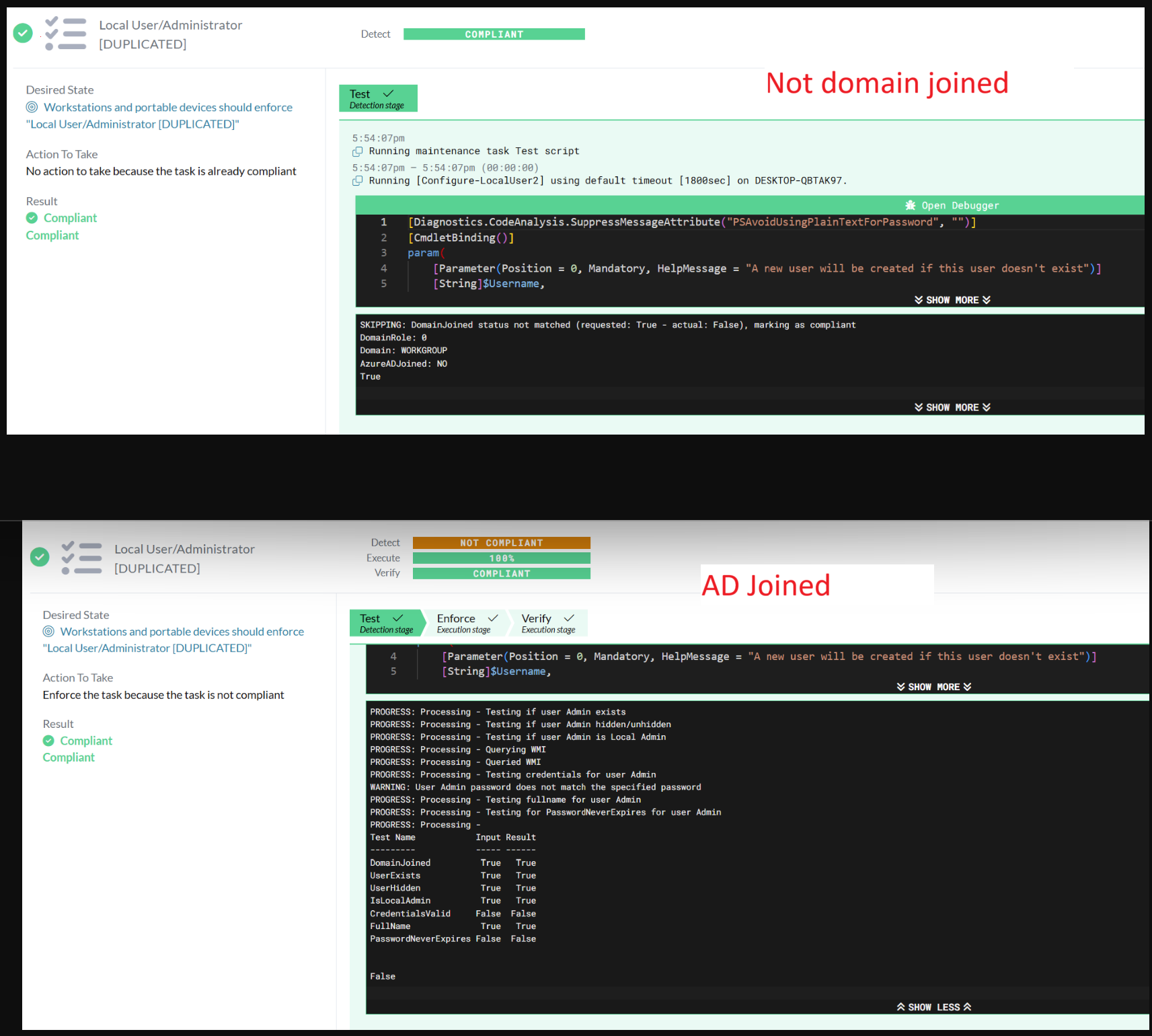

PR: Local User/Administrator - Add DomainJoined param
Task: Local User/Administrator (official)
Script: [Function] Configure-LocalUser.ps1
What:
  • Add DomainJoined Boolean param
  • No-op if DomainJoined param doesn’t match machine status
Why: Want to configure user account on machines Domain or AzureAD joined – if not joined, skip but report status in run. The Filter Script #2170-DomainJoined did not work for AzureAD, and while could add a combo helper filter script wanted local user account function to not be dependent on helper scripts/run and report on all machines.
  • UX: It might sense for a “skipped” stage/status option for ImmyBot as a whole. The concept of only required tasks are pulled into sessions is sometimes confusing when reviewing logs for critical task – for some key tasks a checkbox that include them in all deployments and show as skipped and reason why would be instantly understandable UX, IMHO.

                    Write-Progress "Adding $AccountName to Users Group"
                    Add-LocalGroupMember -SID $BuiltinUsersGroupSID -Member $AccountName -ErrorAction SilentlyContinue
            # Hide account from logon screen
            $UserListPath = "HKLM:\SOFTWARE\Microsoft\Windows NT\CurrentVersion\Winlogon\SpecialAccounts\UserList"
            switch ($Hidden) {
                $true {
                    if (-not (Test-Path $UserListPath)) {
                        New-Item $UserListPath -Force | Out-Null
                    if (Get-ItemProperty -Path $UserListPath -Name $AccountName -ErrorAction SilentlyContinue) {
                        Set-ItemProperty -Path $UserListPath -Name $AccountName -Value 0
                    } else {
                        New-ItemProperty -Path $UserListPath -PropertyType DWORD -Name $AccountName -Value 0 | Out-Null
                    #Add-LocalGroupMember -SID $BuiltinUsersGroupSID -Member $AccountName -ErrorAction SilentlyContinue | Out-Null
                $false {
                    Remove-ItemProperty -Path $UserListPath -Name $AccountName -ErrorAction SilentlyContinue
                    #Remove-LocalGroupMember -SID $BuiltinUsersGroupSID -Member $AccountName -ErrorAction SilentlyContinue | Out-Null
            if (($TestResults.UserExists -eq $false -and $Hidden -eq $false) -or ($null -ne $TestResults.UserHidden -and $TestResults.UserHidden -eq $false)) {
                try {
                    $process = Get-Process "logonui" -ErrorAction Stop
                    if ($null -ne $process) {
                        Stop-Process -Name "logonui" -Force -ErrorAction Stop
                        Write-Progress "The logonui process has been terminated successfully."
                } catch {
                    Write-Warning $_
Example runs:
CC: @TerryW (or whomever else can handle this kind of PR)
