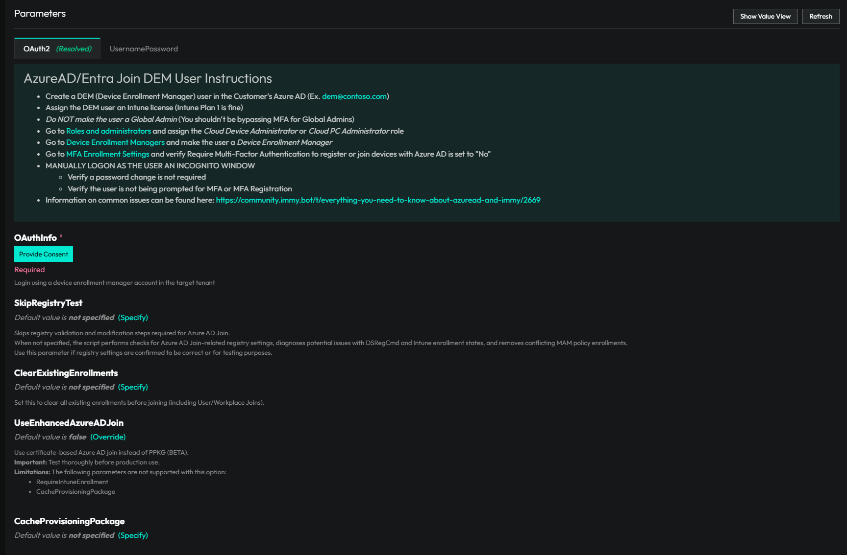

Task "Join AzureAD" Lacks "RequireIntuneEnrollment" Paramater When Configuring
Hi Everyone,
First time posting so apologies if it’s not in the correct category. I also could not find a topic explicitly about this
The topic subject really says it all. But here’s screenshots for context:
When trying to setup the “Join AzureAD” task the certificate references the “RequireIntuneEnrollment” paramater but that’s not actually configurable in the GUI:
That parameter seems to exist in the script as well (Global Script #1123. Discourse didn’t let me add a 2nd image to this post)
Why is this missing as a configurable option?

One work-around is to duplicate any older deployments that had previously been configured when the variable was available in the configuration. The new copy can then be assigned to another tenant and it will preserve the RequireIntuneEnrollment variable as True.
